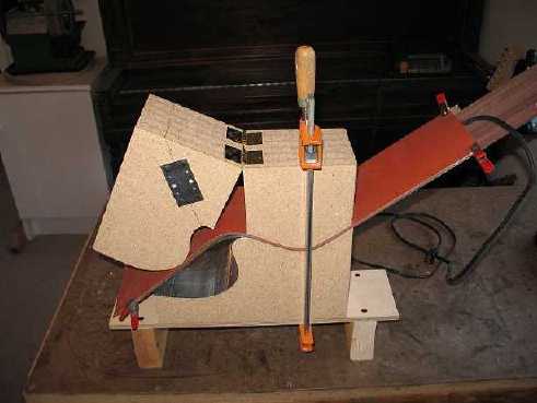

I've only done one cutaway (my Weird Classical), which was
not quite as sharp as this one is; therefore, even with the
easier-to-bend rosewood, I'm still a bit nervous about it. So
what I did today was build this jig I saw somewhere here on the
forum. I've already bent the waist (by hand), and am using a
shorter (uke) heating blanket I had on hand.

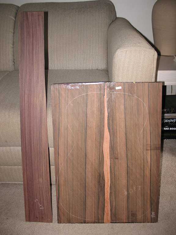

I'm attaching a photo of the jig, and also what my Malaysian
blackwood back (not jointed yet) looks like:
Again, thanks for all the help and encouragement!!!kmatsu38893.9343055556

Here (I hope) are the two photos of my cutaway bending jig (I'm not actually
bending yet -- it's just to show how it all goes together) and my
Malaysian blackwood back (not yet jointed):

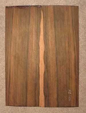

Once again, thanks to all for your ideas!
I think I'm going to still go for the Indian rosewood for the sides -- I'm
attaching a photo of the two together -- it looks pretty close to me. The
only difference would be that the rosewood doesn't have that really wide
striping and is a little more pinkish. At any rate, I'm going to bend the
rosewood sides and see then how it looks up against the blackwood; it
couldn't hurt to try it!
